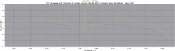

From the logs of today...
435
1,662
...other

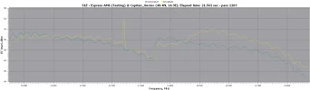

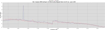

2,357
3,336

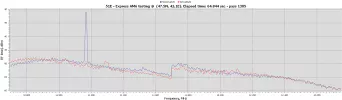

12657 H is 7 dB high, that is much stronger than the 2 db tests in 10.95...11.2 & 11.45...11.7 GHz.
Would 12.5...12.75 be the European beam then?

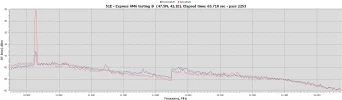

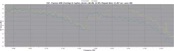

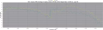

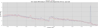

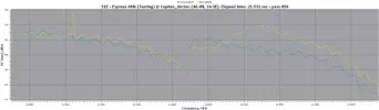

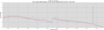

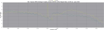

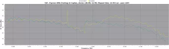

It is interesting news for me, about European beam. Because for me they test again the same TPs third time in circle :) I didn't understood, but now I see why :)

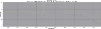

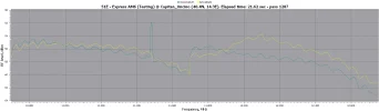

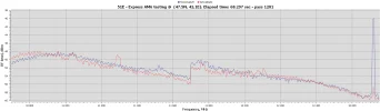

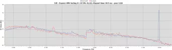

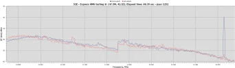

Accordingly to the freq plan, 10950-11200, 11450-11700 and 12500-12750 V+H can be used in Fixed1, Fixed2 or Stearable1/2 beams. So three beams = three tests in circle.

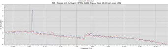

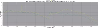

Tests on Express AM6 are only on a single carrier and not on more ,as it happened on other satellites.For this reason the signal has a short life on every carrier tested.
11044 H in on!
2,357
3,336
11044 H now, 6 dB high.
The frequency plan says, a transponder can be assigned to differents beams, so that may explain the same transponders today, with different strength.

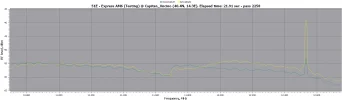

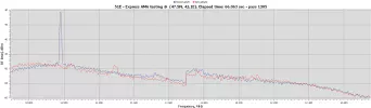

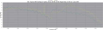

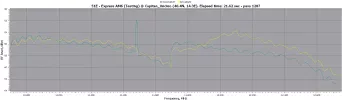

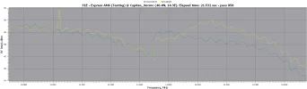

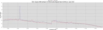

tempo
Aug 14, 2011
370
959
47.5N, 42.2E / Russia

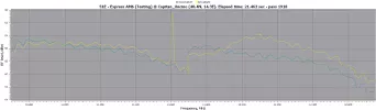

to be precise it was 11107H ;)

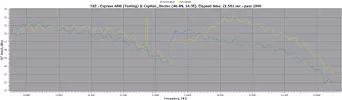

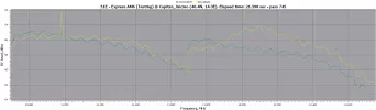

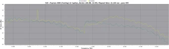

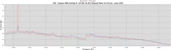

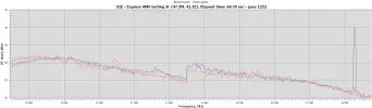

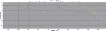

10855V active at the moment. Please also check C-band, I have some peak on 3986 MHz (maybe local terrestrial interference).

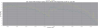

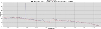

Using my TM1500CI Super+ to find test carriers @ 51 east via the blind scan
One transponder found 10852 V (DVB-S only on this receiver)
This was only active for about 5 min showing as a Red Quality Signal of 60%
