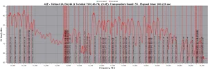

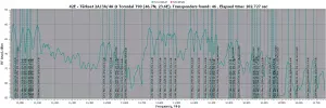

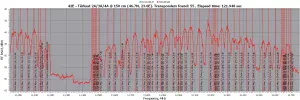

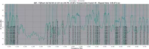

martin-f said:
...be interesting to see some reports from other areas
I've done tests with three antennas at 42.0E:150 cm,110 cm and T90.You have here the reception report with these three sizes of antennas in my area,which I have to admit that is favorable for Türksat.So it's not my merit that I have good signal with all three of these antennas.
