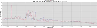

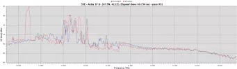

There seems to be mistake on tracking info. It was planned that Yamal-402 will be tested in destination position 55°E.

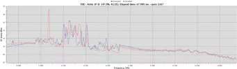

All this week I do monitoring of 55E and 51E positions in different hours: 51E from morning to evening (when Eutelsat tests new bird), and 55E from evening to morning. There were only tests of DirectTV satellite in 56E position, my spectrums published on Ukrainian forum _www.sat-digest.com/forum/viewtopic.php?t=37738&start=180. There still wasn't any signs of Yamal 402 presence in 55E position. On the other hand, when I scan 55E, I have small peaks from 57E, 56E and 53E sats on the spectrum, so if Yamal-402 will be active in 53.75E position, I will be able to catch its test carriers too (see attached spectrum).

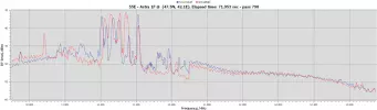

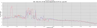

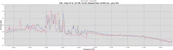

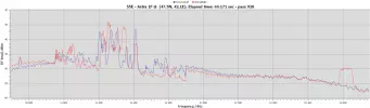

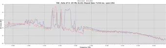

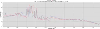

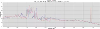

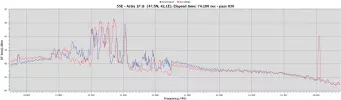

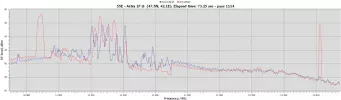

I can confirm, today we had first test carriers from Yamal-402 (55°E) satellite. There were mostly tests of 10885V and 12620V (tps #12 and #9), but for short time carriers on 12620H (tp #9a), 12560V, 11075V, 12560H were active too.

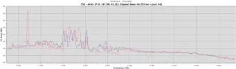

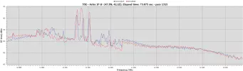

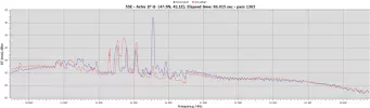

Today they tested again TPs #12 and #9 (10885V and 12620V).

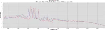

But at midnight by Moscow time (an hour ago) lower frequency transponders of Astra 1F (55°E) were switched off, and 20 minutes ago new tests began.
Right now the carrier on 11511H is active, also sometimes carriers on 11261H and 11261V appears and disappears.
