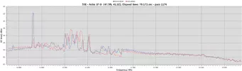

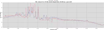

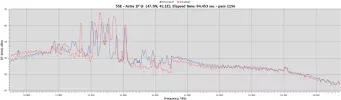

I didn't checked if the signal is modulated or not, I just record spectrums in loop mode in CrazyScan. They uses mostly narrow-band carriers, so I think non modulated. But sometimes I have wide-band carrier, this one should be modulated.
The testing continues again. There were carriers on 11136V, 11160V and 11123H within last hour (after midnight by Moscow time)

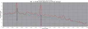

That's how 55E looks like from Kiev on Triax 1.1m
2,358
3,337
Thanks miha20, so this must be the Russian beam indeed.
Suppose 11104V has no video/data (yet)?
