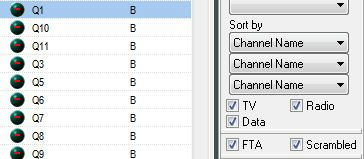

There is a strange frequency on 26E. It's 12380 H 27500 DVBS2
Using DVB Dream, after scanning the frequency directly sports channels shown as normal scrambled TV in Biss.
But on the channel list are shown as data channels.
- They have Vpids but there are no Audio pids.In the same time, they work on a new receiver called beOut Q through all tracks.

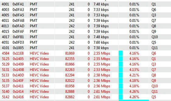

- They are scrambled in BISS but the give fake rolling crypts.
The company ,which owns this frequency and other two frequencies, used to hide PIDs in stream so we can find hidden channels by ts analyzer tools. But this time , the matter is more complex..
I uploaded a small ts file so that you can analyze it. You will find the channels give video pids and no audio pids. Maybe fake Video pids and the real PIDs are hidden.
