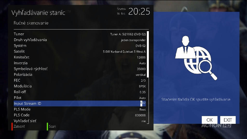

After updating the firmware of the AVL6261C tuner, reception is also possible on receivers with this tuner
EnoSat
May 29, 2004
712
654
enosat.euweb.cz
Slovakia

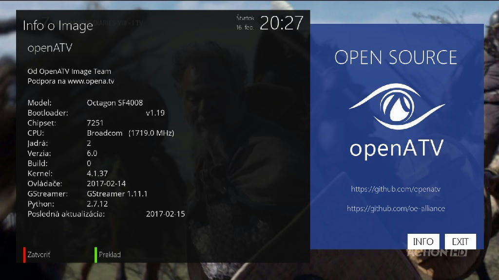

Doesn't SF4008 use Si21662 ?

Yes, sorry, you're right.. maybe a solution in the future, we never know :)
35,613
8,581
There has been no support for the SF4008 for a long while.
Enjoy the receiver for it's quality build and onboard storage.
