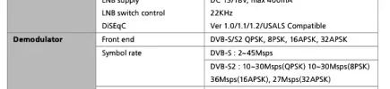

Just been reading the pdf manual, and it says that the chip is 16/32 APSK compatible.
Has any one tried this?
