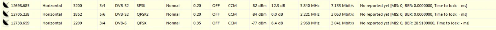

Al Jazeera America_0262 11334_V_27500_20140220_214416.webp58 KB · Views: 60 -
BBC World News HD_0262 11785_V_27500_20140220_214323.webp84.3 KB · Views: 57 -
