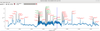

After doing the first time (#503) tests on 47.7E with neumoDVB with inconclusive results, I returned to muxes with a symbol rate of 133000. This time the spectrum looks a bit better, but without correctly finding and locking the two muxes-11790 H and 12020 V, the two muxes with a symbol rate of 62000.
It is amazing how fast it scans 6903x at 47.7E on Linux, about 7 min; unlike Crazyscan under Windows, it seems to take an "eternity."
Interesting that neumoDVB finds a lot of beacons but without a correct identification of muxes with a high symbol rate (133000).
