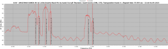

I have not looked at this for a while.The TBS was on the TD88 so had a look.
A scan of 12000 to 12750.gets me one transponder.
12642H 28890 34.
TBS 6925 TD88.

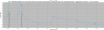

my reception today
12682 V 34280 5/6 Data Channel
