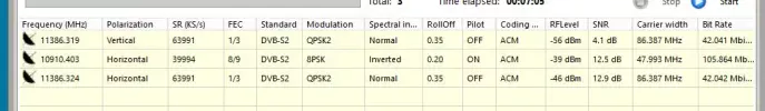

Off topic, but the Combo is sniffing out a signal from the 58/59 E position, 10911 H and sr 40000 if anyone can find a satellite there.

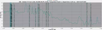

Yes, I cut everyone in front of the antenna :) , and this is the result at 66.0E in my area with Crazyscan and EBSpro:
