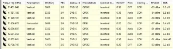

Signal levels in this location on 3W.
From your earlier post I had assumed the change had already occurred, unless you know of feeds from other birds.
A few here.They look to be all from 3 W.

TBS6983 105 cm Dish.

TBS6983 105cm Dish
