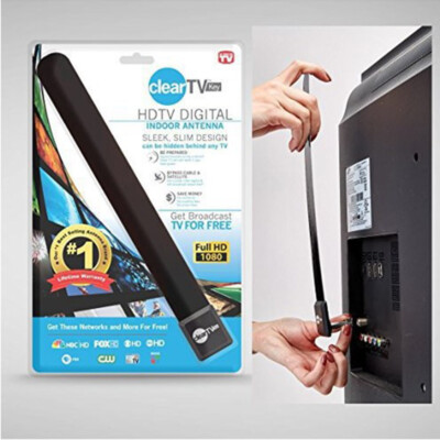

Two too many zero's......

Too many negative reviews on Amazon
Something not right about it

Im a bit puzzled as to why those antenna "sticks" have an f-connector on them!
I like this bit in the description though:
"Note:
Maybe you can not receive as many channels as you thought, it depends on the signal, distance and TV status and other factors."
Or maybe its because they are completely useless??

These are now appearing en masse.
Outstanding, if the claims are true.
You mean "outstandingly useless" (at least in Europe!) - claimed frequency range is 146-176MHz, so not even Band III! :eek:

If it is hard to believe it is true, then it probably is not true, buyer beware
"Problem is" most buyers have ABSOLUTELY no idea about what to beware of regarding these things - to them an indoor aerial/antenna is just a small plastic and metal "thing" that they try to point "somewhere" to get a TV signal (I have a brother-in-law like that!):rolleyes:
