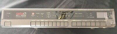

It's the first Echostar I had. It did sterling service for me on long lost Analogue channels in the 90's.
It has the Eurosat TAD module (bottom right) to enhance weak signals - I never found out what the IC type was in it.
There was also a tweak to the tuning voltage section, courtesy of a Roger Bunney mod, but it's long ago now, and I've forgotten the details.
I might fire it up, at least to see if it has survived over the decades :eek:
Looks like it already has some kind of BW control. The IF loop isn't connected. Assuming the de-mod is on the main board, I wonder if this is the way it should be routed:

It's a long time ago, but following disappointing sales in the Middle East, Echostar brought out the SR-5500 LT version with a filter running at 470MHz (I think). This was just about the same time as the power supply issues appeared.

I might try it gently at first with the Variac...
Couldn't be bothered. Straight into the power socket and no sparks or pops.
All I can do for now is check the RF out. It has a restricted channel range of E30-E39 so this is at channel 37.
Aerial Techniques of Poole supplied the TAD module. @Channel Hopper - is that the one your assistant designed?
If it is the one pictured in the receiver then yes.
You should find rubbing the chip surface with methylated spirits brings up the identifying numbers, but I will have an answer mid-week.
