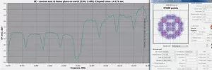

This is what I get scanning 19700 to 20200 ..
The gain does drop off a little at the high end ..this is the fault of the modded SL3.
As you can see the same peaks are present in both scans but then this would be expected if they are circular polarised..
There is also a slight diffence in gain the Blue scan being V the red being H ..and this is due to the SL3 largely as it is set to have the main probe in the resonance chamber angled for Horizontal ..the probe for V bing in the annexed chamber of the SL3 ..thus a little lower in gain.
But as close to H and V as I can get with this lnb...and is reliable.
rgds
VS
