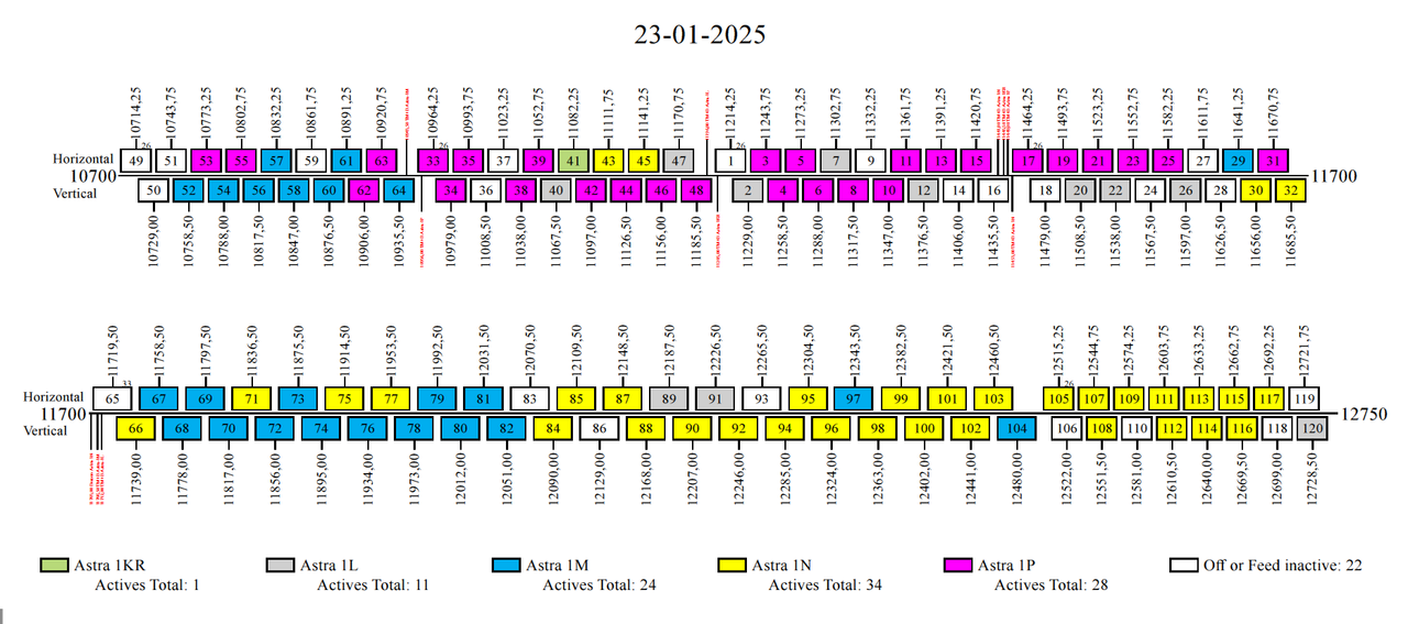

Is 11229V still on 1KR?
YesIs 11229V still on 1KR?
Keep check tp7 maybe move soonI notice that the frequency on which the orf channel was on is worse by more than 1.2 db on the 1.8m antenna in Slovenia after the move.
The new frequency is 11303/22000 H fec 2/3, which means the signal is 1.2db worse than the old frequency.
February 5, 2025, 19:00 UTC.
Vertical
Horizontal
If you look carefully at the images, you can understand which satellites they come from.
The txp-41 is on 1KR, if you look at the top right, I entered the TLE data at the time of the detections, and 1M and 1KR are very close, you have to check at different times to understand the difference. The txp-120 was on 1L, and 1L was also very close to 1M.@Marcus_21 Thank you for your excellent and dedicational work. I examined your images from 19:00 UTC Feb. 5 and I think it tells an even bigger story. You can clearly point out ASTRA 1M/1KR against 1L, 1N and 1P. These are the ones where the green sweep is slightly lower than the blue sweep and the red one is above the black sweep.
Unfortunately, one can't distinguish between 1KR and 1M, but in my view, it confirms that the remaining tps on 1M are tps 52, 54, 56, 58, 60, 61, 64, 67, 68, 69, 70, 72, 74, 76, 78, 79, 80, 82, 84, 97 & 104 (as stated by lyngsat, flysat etc. with exception regarding tps 82 and 102).
Additionally, it seems that (against other sources), Tps 66, 85, 101 & 103 are NOT on 1M anymore. The fact that the uplink provider of Tps 85 & 101 has recently been handed over from ARD Germany to SES, underscores this theory.
On the other hand Tps 41, 73, 81, 82 and 120 seem to be on 1M.
Could you have a look at these tps, please?

It mean 1L all tp move until 23 FebruaryFrom the A1L_THRU.I11 file on the SES website. It is noted that in the night/morning band, Astra 1L from 19,14°E on February 9, goes to 19,34°E on February 23.
If the data is correct and it is not an error. I suspect they will move it to a parking area at 19,4°E... let's see if they will move the remaining transponders this week.
