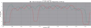

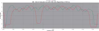

Really like the snapshot time lapse spectrum readings. Shows exactly the moment of switch over for each transponder.
I suspect tonight for the 1N SP to 2E SP the levels will drop from low to nothing on your plot as there migrated.
will be see soon how new spot beam on 2e

I am now also receiving a much stronger signal on 12363V than I did yesterday. I am printing my Crazyscan diagrams daily for comparison.
P.S. I am in Scotland at the moment.
