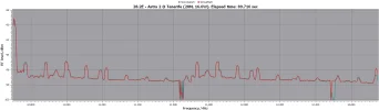

signal levels down today

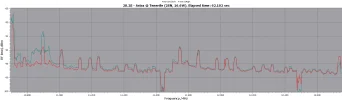

this one on Wednesday
