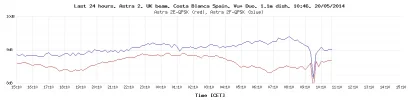

Is it possible to tell from your figures whether that's an actual power reduction or signal loss between the sats and the earth?
How could I tell? Both satellites down in power by very similar amounts, possibly indicating a transmission path event. Or maybe due to a different illumination angle of the solar panels. Or the third possibility is a conspiracy.
About 3db I understand
Nothing like that. Down about 0.4dB SNR currently, but a lot of badly set up dishes in the south Costa Blanca don't have even that small amount in reserve.

and he has a multiswitch system, I think measurements only matter on the LNB outputs, 3db drop on a multiswitch might be caused by someone plugging a damaged receiver on another output.
Camping, on one of your photos, you showed the old 1.8m still installed, it could be used as a comparison, to acess health on the main dish, if performance goes down in both, its not a problem with installation, if only one goes down, its a fault somewhere in the affected system

Yes good idea. We use the 1.8 on one set of channels and the 2.3 on another. Must admit I didn't know anyone watched ITV 2, 3 and 4 but we get a lot of complaints when they go off!

Some weird event here. Dropped power on both satellites (across all transponders) for a few minutes earlier. Not weather related.

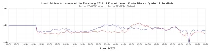

Pity no one else is keeping records to compare with this. Maybe we should set one of these up at your place Brian.
6,036
1,273
And here is the same data superimposed over February 2014 data for comparison purposes.
