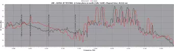

2E and 2F now do pairwobbling after having some intro.
green = 2F
red = 2E
S
Steve Steve
Yea....Ch5 & BBC1 SD London....both slowly have dropped together to 70% Q ...!.....But I'm happy with 70% Q :-)

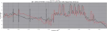

last update for today. The pair still can't properly dance^H^H^H^H^H wobble together.
