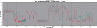

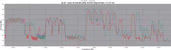

The first three scans are from this morning, I made the fourth (28e.jpg) 10 minutes ago (all signals are somewhat lower, and most not lockable due to rain).
