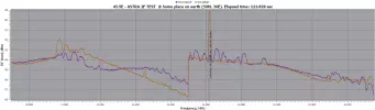

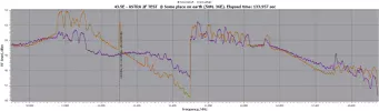

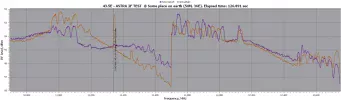

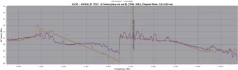

Maybe we have different ideas of what "very strong" means. That spike on your chart is only 4dB above the noise floor. What aerial are you using?very strong
I was only asking because of the similarity between polarisations in my post above.africa beam use linear polairty
how can you tell if its UK beam or WAB you are looking at .Maybe we have different ideas of what "very strong" means. That spike on your chart is only 4dB above the noise floor. What aerial are you using?
