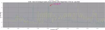

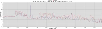

First test carrier... frequency 10714 H

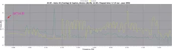

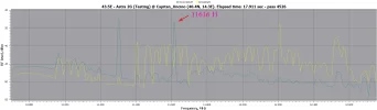

Other test carrier, 11616 H

6 satellite receivers,2 Meters,9 PC cards(tbs6983,6903,6590,6522,6209,2603,6909X,6903X,skystar hd2),2 tuners usb-tbs5927,Skystar HD.

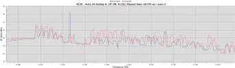

Very strong signal in my area on 11613 H.

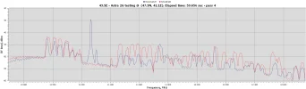

11264 H is activated now:

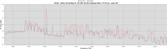

11224 V on:

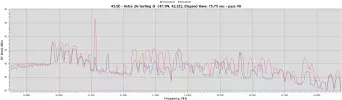

The weaker signal at 12474 V:

Can't confirm. Also 12474 V doesn't match expected frequency plan.
Maybe beacon?
