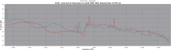

10758 V
ps_Hi William-1,I think 10714 H is beacon.I don't know how much remains.
I am inclined to agree that this is a beacon now.

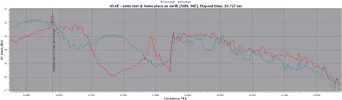

Strong signal again(in fact all of them) on 12095 V

Some vertical transponder activity above 11600 may be coming from Turksat 3A & 4A @ 42 east http://www.flysat.com/turksat42.php
11739V may be from 42 east 11742 V DVB-S/MPEG-2 3600 5/6

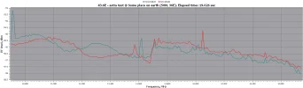

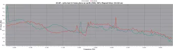

You're right,@William.Must be careful not to confuse the signal from one satellite to another.Even if I have adjusted my antenna as well as possible in the direction of the satellite,the signal from nearby satellites
is active,especially from Turksat.We are lucky that the signal is strong on Astra 2G.

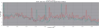

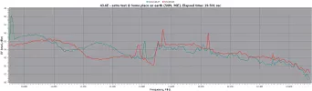

Here's what it looks like on the spectrum signal from Turksat or Intelsat 12 at 43.5 E.

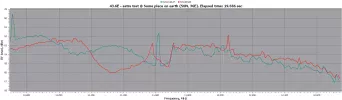

12012 V

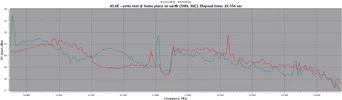

12055 V

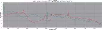

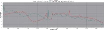

At this hour on the following carriers testing is performed:10714 H,11616 H,11693 V,11954 H,12054 V
