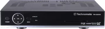

Not to my knowledge my 1st TM5302HD bought early last year was the same size as the TM5502HD (Left image)
My latest TM5302HD is a slimline version same hardware/software in both boxes,
