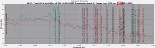

@hvdh is right about the inclination of Yamal 402.
The signal on Yamal 402 in my area at two times of the day, when the satellite is on arc without deviation, and the signal is stronger, so that at noon—12:15 EET—I can receive the Russian beam (112000-11450 HV), and 2, after three hours, at 15:25 EET, this spot disappears from the spectrum. The signal also drops by 3~4dB.
As usual, in the case of inclined satellites, the solution is dual tracking.

With multiple spots (Russian, Northern, Steerable, Southern), the signal is different in my area.
The strongest in my area is the northern beam, but now that the satellite is tilted, the signal is significantly affected, with an SNR drop of up to 3 dB (see the two spectra posted earlier). However, it is still receivable on vertical polarity all the time.
In the upper band, the signal on the northern spot has dropped significantly since Yamal was tilted.
The steerable spot is not favourable in my area. Still, it is difficult to determine which signal comes from it, as most of the muxes are for data, making identification challenging. I don't think I can receive it in my area with my small antenna.
The Russian spot was mentioned in the previous post.
The only thing I'm not sure about is the signal below the band(10700-10950 MHz) that I receive at night. There aren't many reports about transponders that have been found and disappeared over time. I detected some of them recently.
Here's what I receive at night in my area from 54.9E. I haven't found an explanation for its origin. FlySat gives it as the Russian spot, but I don't receive it at noon.
By the way, of all the satellite sites, FlySat posts the most reports of transponders received. It's also a good idea to check reception lists.
KingofSat and Lyngsat are sites more for those looking for TV/radio programs. Enthusiasts post more on FlySat.
