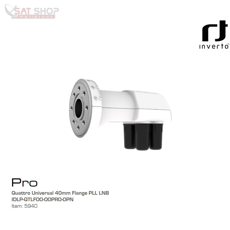

@Channel Hopper Do you have details of a re-seller who has any of these?:
https://www.inverto.tv/lnb/482/single-universal-pll-flange-lnb
https://www.inverto.tv/lnb/483/twin-universal-pll-flange-lnb
https://www.inverto.tv/lnb/486/quad-universal-pll-flange-lnb
https://www.inverto.tv/lnb/484/quattro-universal-pll-flange-lnb

For the moment, I'm happy with the Bullseye. However, if anyone wants an Inverto quad or quattro they are available from Bulgaria at a reasonable price (265лв = 117GBP + tax etc). The singles and duals are not in production.

@RimaNTSS @Slavio_79 Thanks but I don't think that any of those are PLL. This is the current list of Inverto and the PLL ones are indicated LNB - Inverto.tv
The Invacom ones are the source for the flanges I have been using on the LNBFs.
