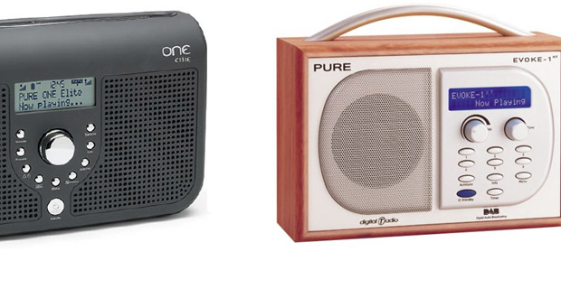

Nearly all Dab radio's sold after 2012 are fitted with the relevant chip for HE-AAC v2. DAB+ so a gradual change over to Dab+ is on the cards from this year as they can get more channels using less frequency they will save a packet & hopefully some better quality radio in stereo,
I bought the Roberts Stream 83i in July 2012 & that plays the Dab+ AAC Stereo transmission ok so it must have the correct chip in it but no Dab+ logo on the set,
The Grundig that I bought in 2010 does not have the chip but I did notice that the newer version released in 2012 did have the Dab+ logo,
So this is a guide as to when the industry changed over so that all receivers sold World Wide after 2012 may meet the new specifications.
