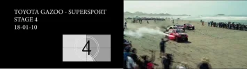

Working OK now on the 88cm dish + TM5302 :cool:DSCN2273[1].webp
