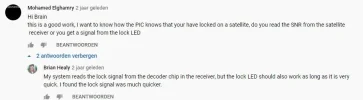

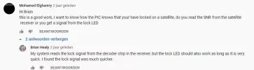

1.8 m CM at SMR 1224 + Elev. with 7 lnb changer Ku (lin - circ) - Ka (lin - circ) C (lin - circ)
Nijmegen Netherlands
Brians answer to a qwestioner
