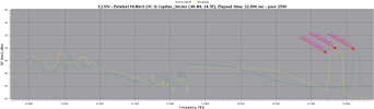

It's still continuing west... the TLE is correct.
It appears to have stopped at 12,5°W. The TLEs report it at 13,5°W, while taking the Eutelsat 12WE (ex W2M) telemetry signal as a reference, they appear to be in the same position (see video).
In about 24 hours, I'll check again to confirm...
This will make 12.5° west very interesting for feed hunters again :)

I confirm, it is at 12,5°W.
Test carriers have also been activated.
