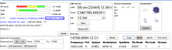

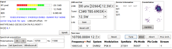

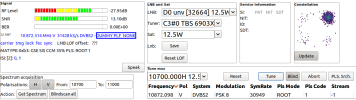

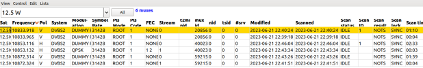

I don't want to dwell too much on the S2X extension of the three muxes to 12.5W. But tests with neumoDVB seem to confirm that this mode is also used.
