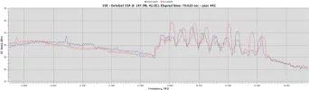

Those six 72 MHz transponders in the range 11200-11450 MHz is only signals which I can receive from 33°E position. I had absolutely nothing from 33°E before. Other peaks on my spectrum (11700-12500) are from Astra 31.5°E.
As far as I remember, when Eutelsat 33B was on 70.5°E, some of those transponders (horizontal) were active without lock too (exclude Canadian mux on 11210H).
P.S. I've added an old spectrum of 70.5°E.

Some weak for me signal is active on 11089H, below lock.
Also transponder's noise picture has changed since my last report.

There are 3 feeds active from Eutelsat 33B at the moment:
11090 H 1922 QPSK 3/4
11098 H 2960 QPSK 5/6
11103 H 5600 QPSK 5/6
All feeds are from Middle East region. The signal is weak enough in my location, but I can receive them on 0.9m dish.
