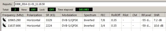

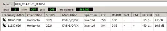

Nothing much happening here.This fine sunny morning.
Only two live transponders.
10965H 3329 7/8
121638H 2229 3/4
TBS6925 100 cm Dish.
