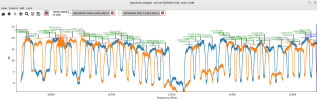

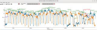

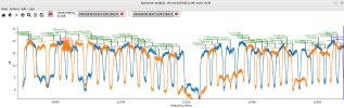

Here is a scan on Hotbird with neumoDVB. It looks like it was after transferring muxes on 13F and 13G.
I scanned with the tbs6903x card, which scanned faster than Crazyscan under Windows.
