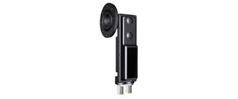

Hi all, i have a question about the extreme high gain lnbf Universal Prime Focus Twin LNB SG-920 or lc 1000 lnb
They come from the Phillepins and China and they are very strong high gain lnb`s.
Have anyone test these lnb`s in a primefocus dish for long distance weak signals ?
Maybe a solution for Astra in the middle east..
I have tried it and found to be good.
But when compared with Inverto Black LNB, I found Inverto to be better in catching the weaker signals.

Yes i know the Inverto flansh lnb and it seems that the lnb is little better then the Invacom lnb now i heard hat the twin lnb i have is better then the single lnb
and the invacom quad lnb (qdh-031) is little better then the twin lnb.
But i have a question about the fuji primefocus lnb. I read in a other forum that the lnb only is optimized for Thaicom and other satelites not or very bad
signal gives. Is it treu or is the lnb good for all sat fref from 10.700 - 12750 ? tel me you experience about the lnb before i wanne buy and replace it for the Invacom
snh twin lnb .. Thx ;)
I tested the Fuji twin LNB on Eutelsat at 9/10 degrees and Eutelsat 16 degrees.
Found the Inverto twin to perform better on weaker transponders.

Then there `s my opinion something wrong with the configuatie wall of the lnb the signal must be much harder can be received.
I heard that the f / d of 0.6 lnb would then power the lnb not the prime focus dish here an f / d of 0.35 has
Take a moment to figure out what is true and what is the reason why the lnb not optimally perform well, odd wad it should be better.
I have found a site where you can focus on exactly when you calculate the diameter of the dish and take its depth ..
I agree with you that we should have a feed-horn that is compatible with the dish F/D ratio.
A wrong F/D ratio results is either under or over illumination the dish.
i.e. we get signal from part of the dish or get noise from around the dish.
I have sent a message to the China fact for f/d specs
Also for lc 1000 lnb .. Waiting for replay message ..
I got a message back but I had not got here yet.
Meanwhile I have discovered a good alternative because a flange lnb with 70 dB conversion gain (Like lc 1000). If this flansch lnb has the same dimensions as a Invacom ADF 120 of the upgrade would be a big improvement .. I think the fd lc va n 1000 0.6 instead of 0.35 because they have other dishes as we do in Europe.
