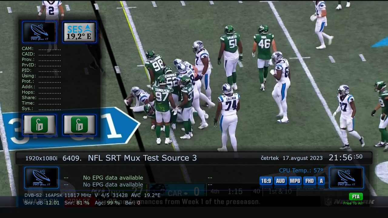

Encode_1080P_19.mp4_20230818_124855.803.jpgEncode_1080P_19.mp4_20230818_124949.755.jpg
12,5 dB
