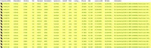

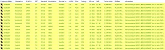

This is my yesterday's evening scan, 11728 H is not always lock (8PSK)
but with good weather conditions 11728 H is locked
H:

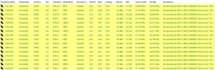

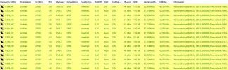

Scan today shows that even with the 1.2m capable of a great .db level and a few clicks east pulls in a lot from nearby 5.0ºW.
7.2ºW  a  04-03-2015.JPG 7.2ºW  b  04-03-2015.JPG 7.2ºW  c  04-03-2015.JPG 7.2ºW  d  04-03-2015.JPG 7.2ºW  e  04-03-2015.JPG
