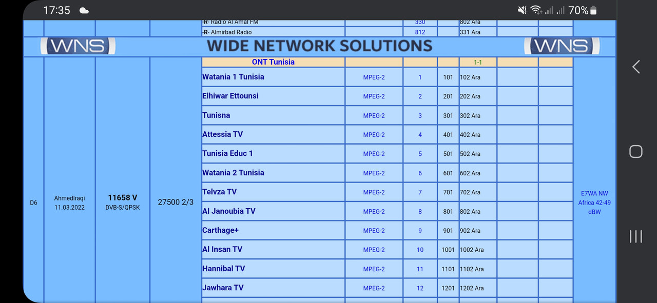

And how about Eutelsat 7WA on 7.3E, the beams are totally different.
Sure, those are two different satellites, 0.3° apart.
7WA gets here with 1 meter antenna, NWA beam with 2.4m upwards.

The exact opposite happens in Northern Greece. 201 is fairly easy with 1.20 (all frequencies come from 8 to 11db) but 7WA MENA is extremely hard, with some frequencies not possible even with 2.40!

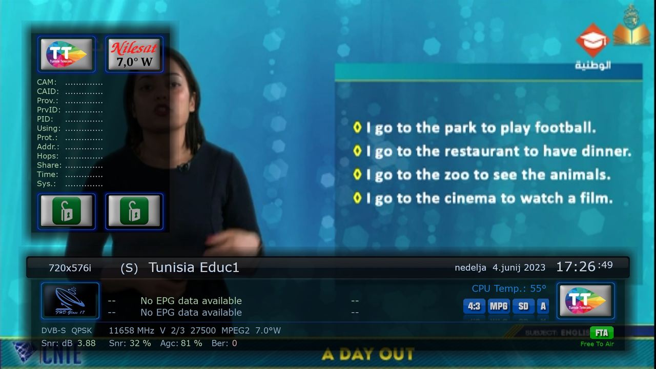

For the first time I caught this frequency in Slovenia with 7w.

Location, antenna size, receiver?
Triax td110, technomate 2600, inverto black ultra lnb, octagon sf8008 opevix 6.4.something in Nottingham.
Thank you! I assume 33% is about 5db (and why not used, since SF8008 can display it).
