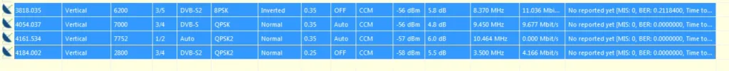

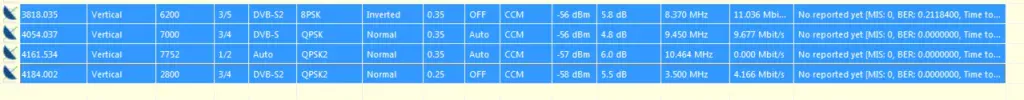

3732 V has changed modulation for 8PSK but strong signal now

Thanks for the info - Feedsat_DXer for the past few days i have the 3 m prodelin lined up on this sat and i,m receiving 3732 V at 8.0 db here tonight -- this is a first time lock on this transponder for me :)
Anonymous_1
You're right nelson, until today it was impossible to lock this one with a 3.1m from this part of Europe .
On tuesday a first sign, the fec was 3/4 instead of 5/6 in QPSK-S2 but weak and today: Surprise :cool:
