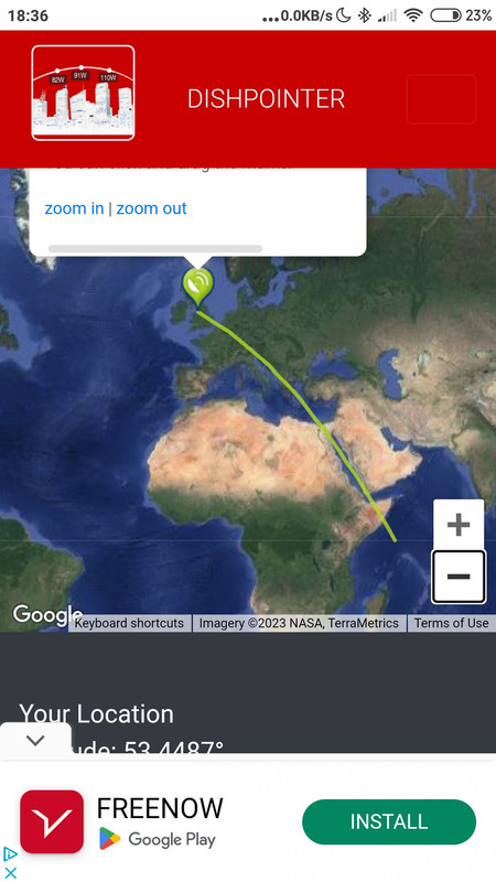

If your looking to try for 52E from your location, try the site at dishpointer dot com, enter your address, select the satellite your looking for, this will give you a map with a line pointing to the satellite, you can zoom in and move the marker to where the dish will be located, it will also give you an idea if the satellite will be blocked by something.

On the .com site I get this line not sure how to check for obstacles,

Point your search to within about 10 miles of your location.

Can you redo the pointer app but on a laptop or computer, you can ten zoom into your location at ground level and then it will check for anything in the way
