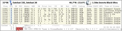

I did a more thorough scan at 33.1E with Crazyscan,EBSpro and IQmonitor apps. No sign of mux with low symbol rate and DVB-IP stream feed.
Interesting scan, thank you! My best guess would be it could be one of those relatively low SR muxes between 11066 and 11140 V.

It was precisely in this part of the band(10950-11200 V) that I scanned in particular with IQmonitor, knowing that in past years I found such muxex with low symbol rate. This time, as I said before, I did not find this transponder :(
I hope to be disproved by other users.

I finally found a mux,11153 V,952 Ks with IQmonitor,but with a question mark, but no stream.
Ahh that's a pity, so no TS data receivable from that mux?
What's on 11141 V 2500 QPSK 3/5? It's listed on Flysat as 'AOL' so maybe nothing, but it seems quite narrow bandwidth.

Indeed, on 11140 V we have an AOL. I checked other pids but it doesn't take me anywhere.
As an aside, I'm usually looking for such "truffle" like you, but I assure you if they were on this satellite I would have reported it. That doesn't mean they can't be discovered as long as you have better tools. Maybe in this case there are enough dvb apps that we use as usual.
Of all, IQmonitor also looks for subliminal signals and sometimes finds them and in some cases lock them. But that can't help us if the settings the broadcaster makes are not hidden or encoded. Of course it's a fanciful hypothesis.
I wonder, how do you know for sure that on this satellite is broadcasting Radio Vinci?
