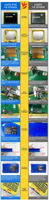

A page showing original and clone Freesat meter differences.

BTW: I checked out your stripdown of your bravebox and it looks very similar to mine, you even managed to get the heatsink off the chip (which I still have not managed to do (although, I don't even know if this is the main CPU or just the demodulator) to mine (not sure how to do that, without damaging the device further)
@Manikm909 which one did you have in mind when you said: "I have the first one pictured. It's good but it loses any customisations", the GTMedia V8 Finder Pro one, or the Satmessgerät Digital 1 HD?
Yes I got the gt media V8. Will be selling soon
