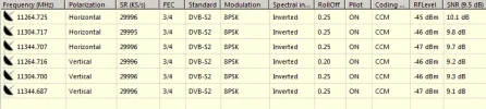

Helsinki, Finland
35cm, Sharp LNB, DrHD F15. Good reception on all frequencies
Measured yesterday from ~120cm dish where 13*E in focus and 4,8*E in multifeed (so, probably, equivalent of 90cm in focus).
Thanks, what's your nearest town?
