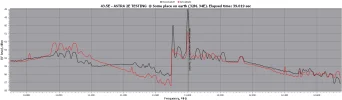

signal strong at ever more then 2f
11802h 6 db
6,414
3,659
11802h
c.n 3.1 for now
