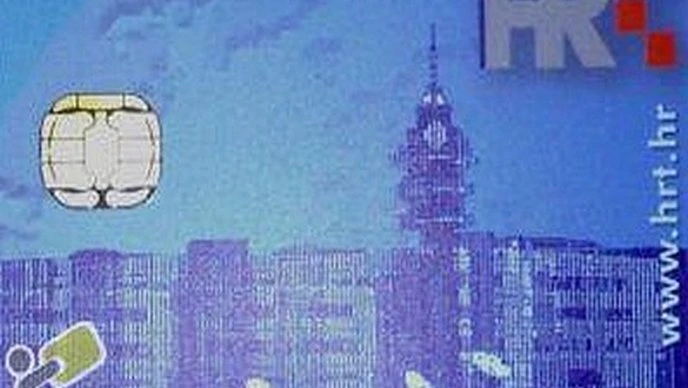

The Croatian channels are encrypted for much of the time - apart from the International channel which is fta.
Subscription cards used to be available for them although I havent seen anyone selling them for ages

Regarding the hrt card, the condition is the payment of 25 euros for renting the card for residents of Croatia and the monthly payment of the rtv fee. I think there is also the possibility of buying a sat card for abroad, but I did not find the price and conditions. However, this can also be solved if you have someone who lives in Croatia. and takes the card and sends it to you. No one does the checks anyway, I've never heard of such a problem.
