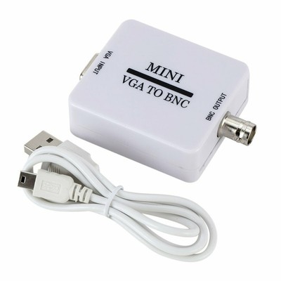

Looked again at the VGA to BNC converter but wonder if that would work over the 20-25m of cable from the NVR to the lounge TV, and then what would needed to convert back to either the phono AV i/p of the AV Rx or to VGA for the TV itself?
I don't know what inputs are on the back of the television, but a composite video signal will happily run down RG6 coax cable for hundreds of feet.
