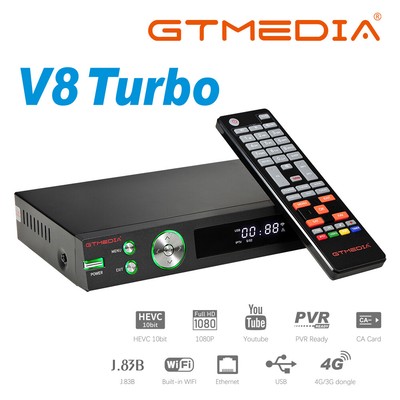

Thanks for the advice, I had been looking at this promotion that infers the receiver would be able to read the TNTsat card, though perhaps the specification is more to do with the terrestrial side of the box.
(but is the terrestrial service also called TNTsat or just TNT ?)
That box looks dubious to me, I think they’re implying that it will decode TNTSAT in the way I mentioned above. I say this because one of the pictures on that listing also mentions “Albertis” (sic), which is referring to the BISS-encrypted professional Spanish DTT feeds on 30°W, as well as “BBC Satback” (BISS encrypted Freeview feeds on 27.5°W).
I would take a look at TV Corner - they specialise in French equipment.
Yes, it was their site that led me to think about using a PCMCIA since a Fransat one is offered for the 5W service.
