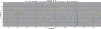

same here... the verticals are at 72-75% sq but zilch off the horizontals

The East Beam is much further away from the UK than the other East Beams from 42 east.View attachment 66411
