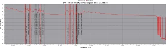

Yes,I get not only signal on 11495 V but also the signal on all frequencies on the Intelsat 907 with 150 cm dish(in avatar).Taking into account that I am outside of the footprint of the satellite and for those who want to compare what is to be compared,here's how it looks the signal on the spectrum.
